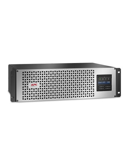

APC Smart-UPS, Line Interactive, 1500VA, Lithium-ion,Rackmount 3U, 230V, 6x IEC C13 outlets, SmartConnect Port+Slot, Short Depth
$3,911.88  Inc Tax
APC Smart-UPS, Line Interactive, 1500VA, Lithium-ion, Rackmount 3U, 230V, 6x IEC C13 outlets, SmartConnect Port+SmartSlot, Short Depth, AVR, LCD
This APC Smart-UPS is designed for IT professionals or network administrators to maintain business uptime and continuity. The 1500VA line interactive 3U short depth rackmount UPS provides pure sine wave power to support critical electronics during power disruptions. It comes with IEC 320 C14 input and 6x IEC 320 C13 outlets. It offers cloud-based remote power monitoring, UPS firmware upgrades, remote diagnostics and proactive email notifications with recommended actions. The UPS can connect to EcoStruxure IT or third-party centralized management platforms. It provides surge protection against lightning strikes, power sags, brownouts and surges.
Run time for load 1350 W 5min 9s
Min-max: 150-1350 W
Max. Capacity Used 100 %
Main Input Voltage 230 V
Other Input Voltage 220 V, 240 V
Main Output Voltage 230 V
Other Output Voltage 220 V 240 V
Rated power in W 1350 W
Rated power in VA 1500 VA
Input Connection Type IEC 60320 C14
Output connection type 6 IEC 60320 C13
Number of rack unit 3U
Battery type Li-Ion (Lithium-Ion)
Provided equipment- Installation guide, Rack mounting support rails, Smart UPS signalling RS-232 cable, USB cable
(power cable not incl)
Acoustic level 45 dBA
Heat dissipation 135 Btu/h
Operating altitude 0...10000 ft
Ambient air temperature for operation 0…40 °C
Ambient air temperature for storage -15…45 °C
Storage altitude 0.00…7620.00 m
IP degree of protection IP20
Relative humidity 0…95 % non-condensing
Storage Relative Humidity 0…95 % non-condensing
Input protection type Circuit breaker
Input voltage limits 151...302 V adjustable, 160...280 V
Network frequency 50/60 Hz +/- 3 Hz auto-sensing
Mounting mode- Rack mounted
Compatible Mounting- AP9335T, AP9335TH
Compatible NMC -AP9613, AP9810, AP9640, AP9641, AP9643
